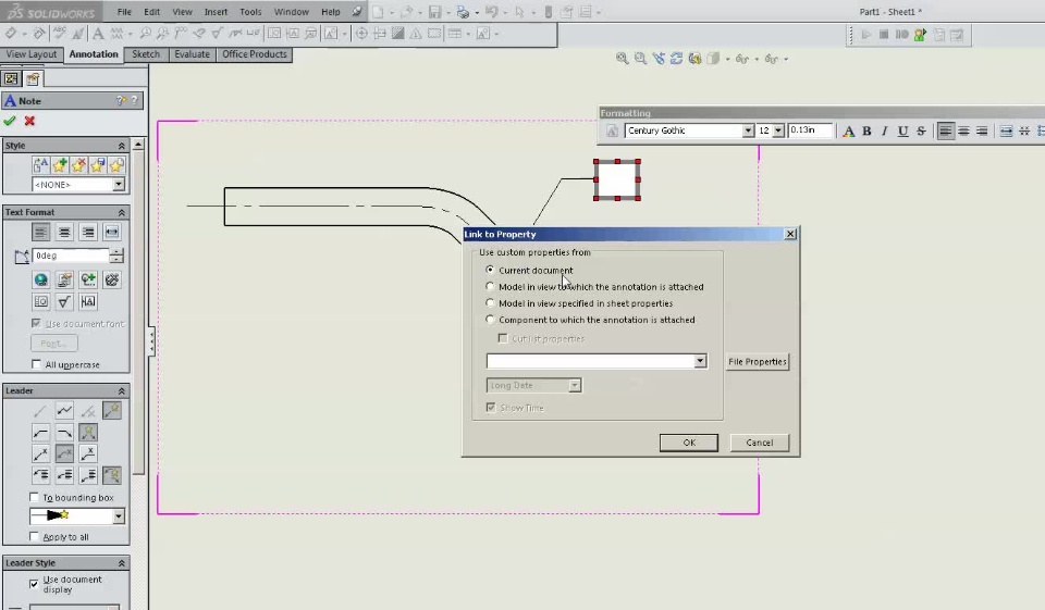

I've created a drawing referencing one part and attached a note (annotation) to it.
The part has been given a configuration description.
I want the annotation to show the configuration description.
I can get the configuration name (shows up in the BoM as Part Number), but not the description. The description is the one that would appear in the Bill of Materials Description Column.
I tried looking up and using various \\\$PRPMODEL, \\\$PRPVIEW, etc, however I really struggled on finding a list of suffixes which follow these prefixes.
For example, the Configuration Name is \\\$PRPVIEW:"SW-Configuration Name(Configuration Name)".
The prefix is: \\\$PRPVIEW
The suffix (or whatever): "SW-Configuration Name(Configuration Name)"
Where is the list of these suffixes?
