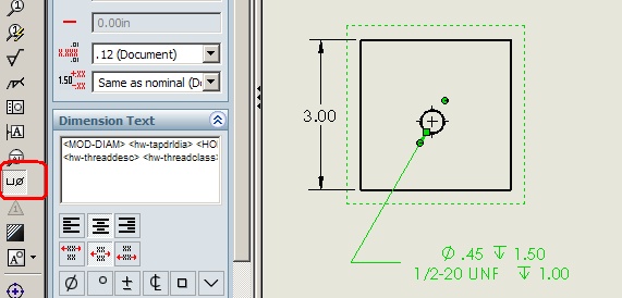

I've been trying to link a dimension of the depth of the cosmetic thread (created with hole wizard) from the solidworks part to a drawings dimension so that depth of the hole is automatically changed in the drawing, if the part is changed.
An example of what I've been trying:
M
Where D1@Hole Thread2 the full name of the dimension is.
I'm working on sw 2007 sp5
Does anyone know how I can link this dimension?
