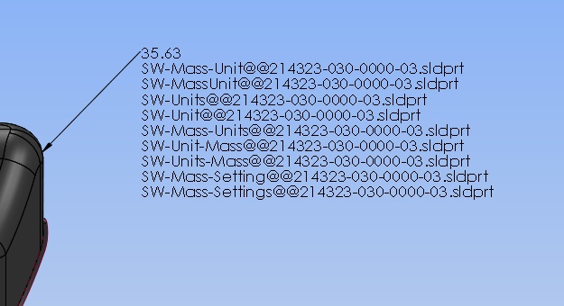

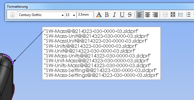

I'm in the thermoforming business, so we measure our products in grams, and our tools in kg.  I make many more tool components than products, so my drawing templates are set up for [Weight: \\\$PRPSHEET:"Weight"kg], with "Weight" -> "SW-Mass@@part.sldprt".  I manually changed the "kg" to "g" in the drawing, as I often do, but I later changed the sheet size, forgetting that I would have to reset the weight units again.  Our official drawing now says that our small plastic product weighs over 100kg...
Is there a way to link the units as well, such that the set up would read something like  [Weight: \\\$PRPSHEET:"Weight" \\\$PRPSHEET:"WeightUnits"], with "WeightUnits" -> "SW-Mass-Units@@part.sldprt"?
I've been searching the internet, but I can't seem to find an answer.  So, I've been playing with the annotations (SW-Mass-Units, SW-Unit-Mass, etc...) to see if one works, but the results have been fruitless.
