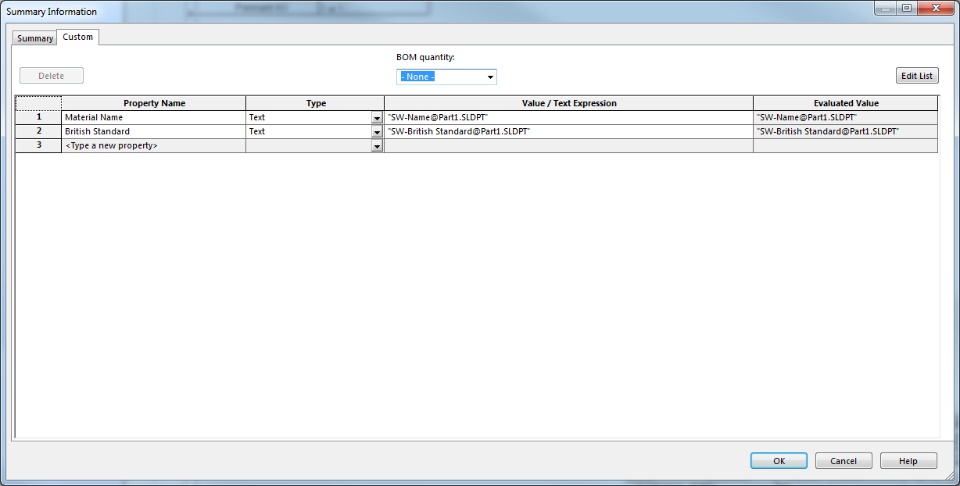

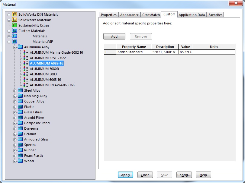

I've setup a custom property for the material with he property name British Standard and the Value BS EN 85: 2005

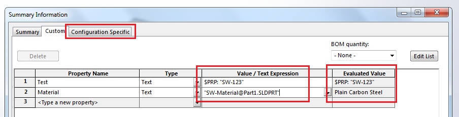

and I've set up a custom property in the template

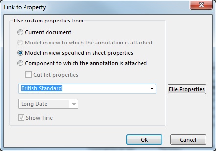

and pointed he note at it

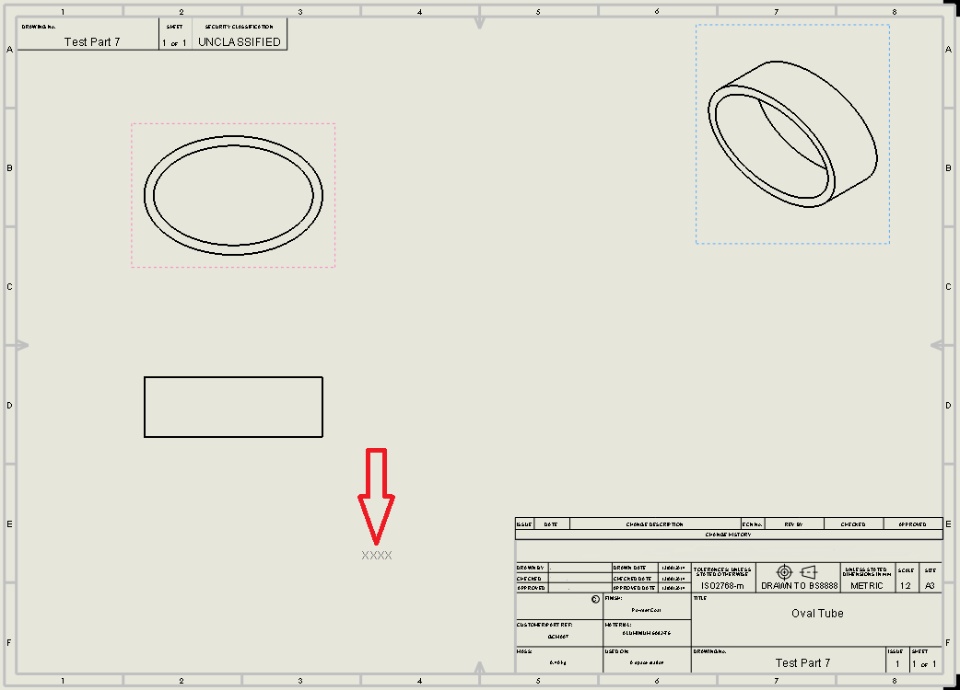

but when I use the template to create a drawing
the note just comes up blank.
What am I doing wrong?  Any pointers gratefully accepted.
