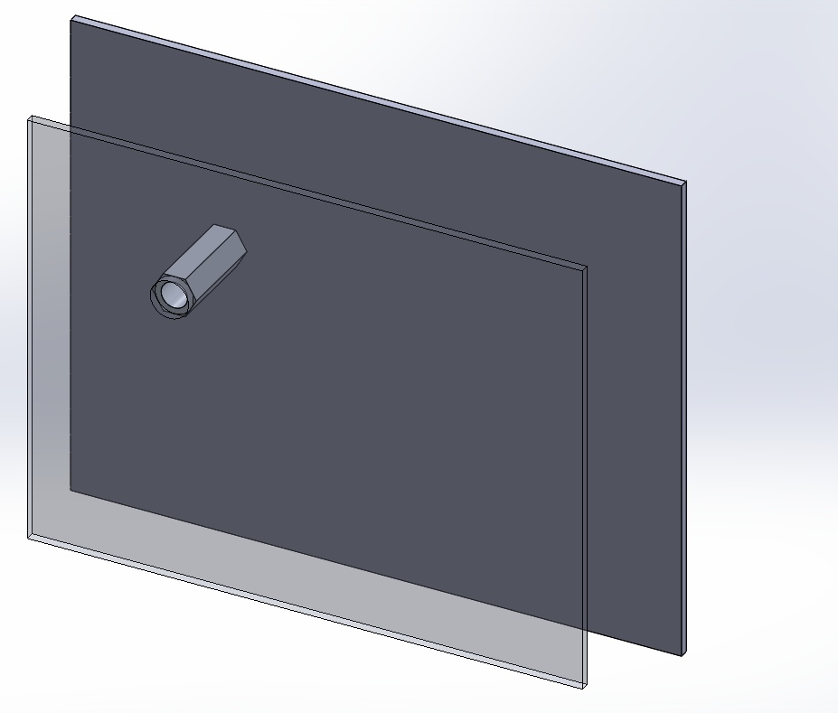

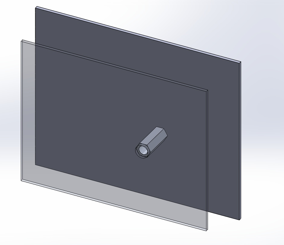

Anyway, I have a parent Assembly I call a Group (a combination of assemblies and parts). In this group I have two sub assemblies, A and B. A is the back panel of a box that has parts on it. B is the door. The location of B references the location of a part in A.
My question is: Is there a way to make sure that regardless of the configuration that A is in, B will always place itself relative to the location of the part when A is in it's "Default" configuration? I know that I can remove the dynamic external reference, but that really takes away a lot of the power of Solidworks. Also, there may be a case where we actually want to change the part we order to how it is in a difference configuration, or we may split the different configurations into different parts. See below for a dumbed down version of what I'm asking.
Config One (A in back)
What I want to have happen
What really happens
