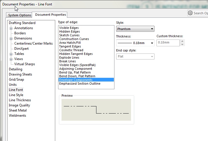

Okay, my line font options have my Envelop Components set to a .18mm line thickness, and a phantom line like this:

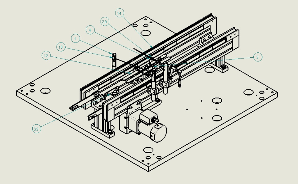

My drawing view is correct, and it looks like this:

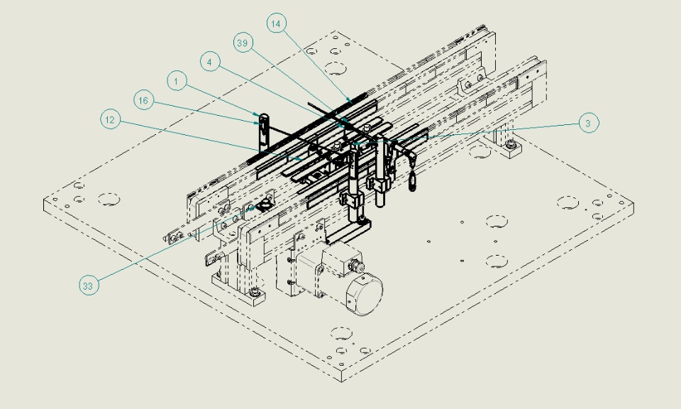

When I check the drawing into Solidworks PDM Professional it changes to this:
What is going on?  If I check the drawing out and mess with the component line font I can get the drawing view back the way I want it, but then when I check it back in it goes back to the bold solid lines...  Is anyone else experiencing this?
