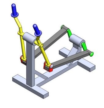

limit distance for one part to the maximum distance of another
I have two parts in the assembly that one needs to depend on the maximum distance of another. To make it easier I have taken a picture to show exactly what I mean.
I want to set the maximum distance of the two top of the handles based on the maximum distance of the green link. When one handle is in the outward direction,the green link is also at it's maximum distance towards the back. Is there a way to accomplish this limit with a mate? Without this limit the handles rotate 360 and become upside down. I am trying to top at the limit just before it does that.
