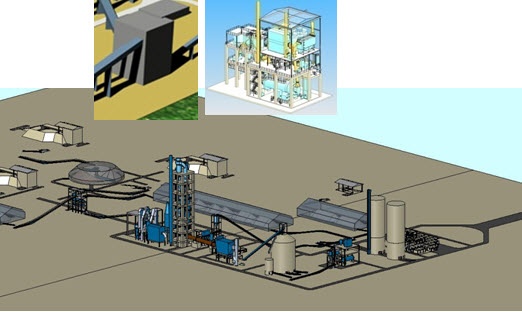

Layout tool
A layout tool with some new features.
* Layout component in Design Library
   Defined only as "up direction", No mates is needed to use them.
   They will automatically mate on the ground / floor or ontop other objects- like Lego blocks.
* Snap to underlaying DWG file.
  When inserting a 2D sketch it would be great if an inserted component would snap
   to the floor and entities in the sketch automatically.
* Move component in grid system.
  No needs to use mates. When moving the components they will snap to the next grid.
* Do not rotate under "X-Y plane" setting
  There should be a setting not to rotate under the ground. (also in eDrawing)

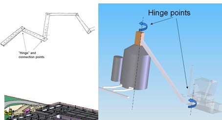

* Hinge behavior
   When editing a layout, panning & rotation on the plane is the most common.
  A hinge behaviour between components would help editing.
  This comes from one of our biggest customer that makes plant design.
