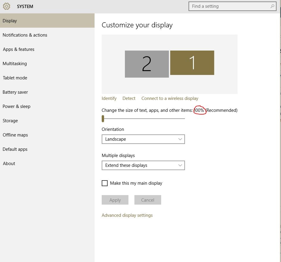

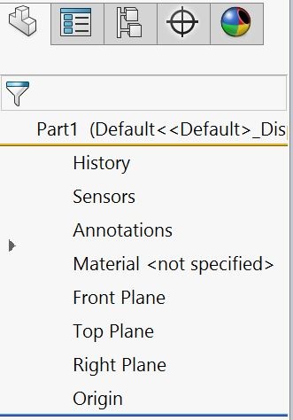

I just received a win10 Dell Precision 7710 () with a 4K (2160) display.  After getting things dialed in how I liked I went to use Solidworks and my icons were missing from the Feature Manager Design Tree (see  attachment: Not OK at 2160.jpg).  I suspected a driver issue but this showed up the same even when running in software openGL.  It seems the root cause is running your scale setting at 175% with a native 4K resolution on the built in display (see attachment: scale setting.jpg).  Running at 100/150/200% scaling seems to remedy the situation as does running in 1080 resolution.
