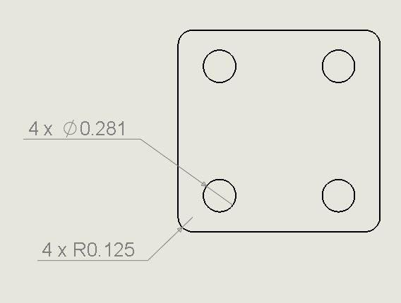

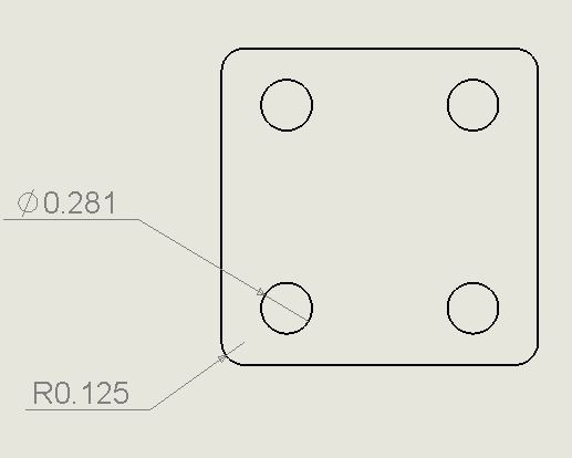

Hey Guys,
I am trying to make a macro that I select a drawing dimension and it keeps the current prefix and then adds a new prefix in front of the current prefix.  For example the dimension would be displayed as a diameter symbol and then the diameter.  I want to add a quantity in front of that diameter symbol without deleting the diameter symbol.  I am trying to modify my current macro that deletes the current prefix and am having problems getting the current prefix. Below is my current macro and snips of before and after for what I would like the macro to do.
Any help would be great!
