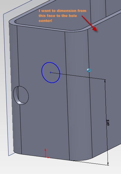

I had some free time today and decided to start playing around inside of SW 2011 MP5. I create a very simple part and I am attempting to cut a hole thru a portion of the solid.
The solid is a simple extruded rectangle that has outside blends and then a hollow applied to it to create a structural tube.
I now want to put a hole thru one side of the tube. The problem I’m having is that I cannot- for the life of me- get SW to allow me to locate the circle sketch from the edge or face of the exterior. I do NOT want to dimension off of the fillet. I’ve tried several different things and the only thing I could get to work was to place a plane on the planar face- which to me is redundant. I have even tried to convert the edge so that maybe I could use a point and even tried creating an intersection curve by selecting the two perpendicular faces..this really can’t be so!
Why can’t I locate a hole from a face or edge? My design intent is to locate the hole from the mounting face- not a fillet tangency edge! I would like an answer based on deisgn intent not on part history. I know that I can reorder to get the results I want but that requires that I know where all my holes are prior to my actual design process!
Frustrated….

If you don't want to dimension from the fillets, then put your circle sketch before the fillet. If the fillet is in the sketch for the rectangular extrude, remove it and make them fillet features. Or you could show the sketch for the rectangle and dimension from the endpoint of one of the lines.
I'm not defending the way it is, just trying to show how you can get where you want to go given the limitations of the process and your demands.

Thanks Matt. My first attempts I was attempting to grab the sketch line and not the end point.
So what causes me not to be able to position from a face but still allows me to select a plane on the same face? Don't both options provide me with a "intersecting" line on the sketch plane?

I don't understand why you don't want to dimension from the tangent. That is, after all, the edge of the side face.

To your point- the edge that is "trimmed" back is also an edge on the same face.
There are many reasons I don't like to dimension to tangents that are created by fillets. In this specific case, yes, the shape of the part is actually determined by the steel mill and the tangent/fillet isn't a problem.
The primary reason I don't want to associate a feature with a tangency is that it keep my dependency structures as flat as possible which provides robustness in model changes. This way the hole, which is critical to the design, is only associated with tube/extruded face. Any changes to fillets don't cause or require the system to look at tangency. If I decide that I need to remove an edge from a fillet set I don't have to worry about the hole position failing. A failure could be critical to a design if that dimension is actually driving other parameters in your model. Keeping your structure as flat as possible and still maintain your design intent- I feel- is the best modeling practices out there.

I understand about edits that will loose you your dimension. In many cases I try to start with a layout sketch or work with reference planes. Otherwise I just live with redimensioning.
I would guess, even if you could dimension to a face, that when you did delete the fillets then the face ID would change and you'd loose the dimension anyway. Matt's advise is good.

Face ID shouldn't change only the boundary.
I also agree that Matt's advice works and that skeleton sketches are important. I've yet to get those to work the way I am used to in other systems. I've got a lot to unlearn and relearn when using SW!

You could use a 3D sketch (created on the face) to create the hole. That would allow the selection of a face when locating a dimension.
Using the Hole Wizard allows the same.

Kelvin mention the 3D sketch but I couldn't find it during the extrude cut positioning. The hole wizard is were it was as you pointed out. So a "Thank you" goes out to both of you!

Start a 3D sketch, select a face (or vice versa), draw the sketch elements and then create the extrude-cut.

Maybe I'm missing something here, but you should be able to dimension from your hole to the outside face of the body.  I do it all the time.  Were you sketching with your model at an angle?  If that's the case, then it probably wouldn't work.  If your sketch plane is normal to your screen when placing the dimension then you should be able to select the outside edge of the body without a problem.

Yes, you are correct but the edge that gets selected is the shared edge of the fillet and side face. You loose your associativity to your dimension if you then later remove the fillet. That is the primary reason for my request to attach the dimension to the planar face or face edge that is located normal to the sketch plane.
