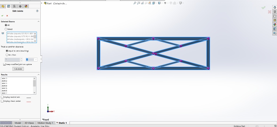

I am trying to make a truss and run a static simulation on it. After making the truss, if I run the simulation it works fine. But if I trim the edges of the cross bracings and run the simulation, it shows some of the truss member joints aren't there.  I am using SolidWorks only for a week.
This picture shows all the members are connected. But after trimming the cross bracing members, this is what the joint connections show,
Can anyone tell me how to connect those members? I have also added the .zip file.
