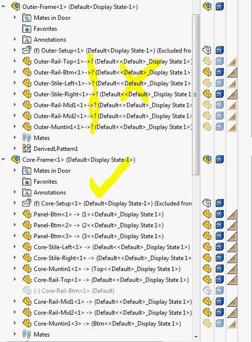

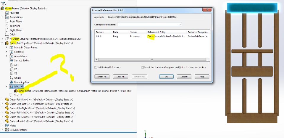

SW has been misbehavin this week, big problem with a joined part jumping references to a completely different file.
No way to edit or repair.  Absolute killer.  Happened twice now.  Once just randomly and once with a Pack'n'Go.
VAR can't help.  Mentioned that's there's some SPR about Join.  Same thing happened to a Cavity.
The file thinks it's in context, but the feature is out of context and editing in context jumps to a completely different sub-assembly.
Just happens to one of three similar subs.. that were all spawned from the same master sub using Pack and Go.  Somehow something is majorly messed up with this workflow.
