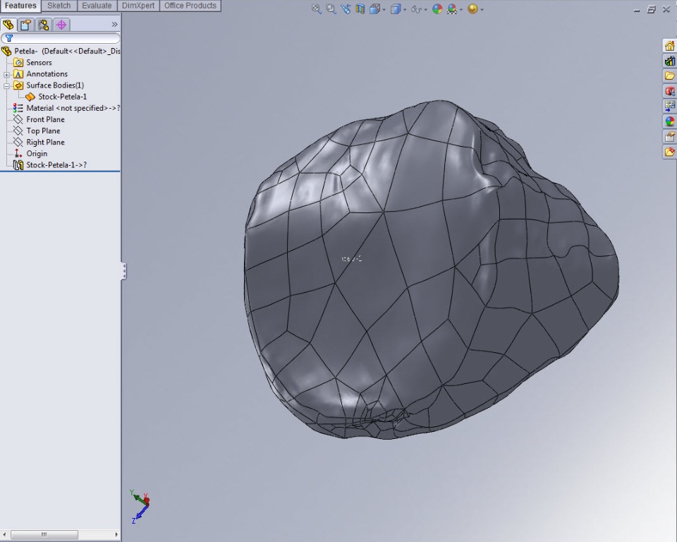

My name is Bruno Santos from and I am making a work at SolidWorks but I have a problem and maybe someone can help me.

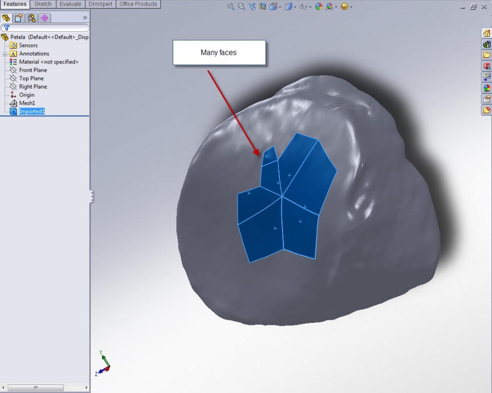

The problem is the next, I create a single surface with a point cloud data. So I used the mesh to create a surface wizard following the Automatic creation path. After choose the surface detail I get the single surface but with multiple faces. So, How can I join the faces to reduce the amount??
I really need to reduce the quantities of faces in order to run the solid on Abaqus, and with so many faces that will cost me days.
Attached there is an example.
