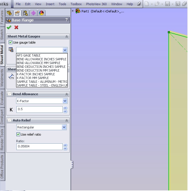

Then it occurs to me that using "fix projected length" and allow me to enter a known allowance there and I'm done. But it doesn't work that way! Anyone in this business for a decent amount of time knows that a joggle shortens the blank. We're not concerned about the height of the joggle (so much) as that is controlled by the depth of penetration of the tooling. We are only concerned with the amount the blank shortens, that is the joggle allowance.
A k-factor cannot be used because it is not consistant even in the same material. A k-factor would be one number for a joggle that is 1/16" deep and then a totally different number for it if the joggle depth was 3/32". We do send out parts that have two joggles in the middle area and mounting holes on the ends that need to be within .010 after bending.
