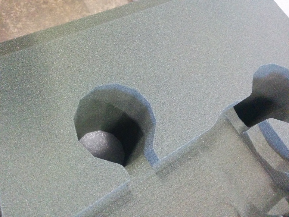

I am trying to locate what solidworks setting will reduce the jaggedness of surface features created in solidworks. This is not an STL export issue as it would be across all part geometry. This jagged defect is only on surface features generated in solidworks that is used with the split command to create the pieces of the 3D Printed Sand molds.
Image of Printed Jagged Circles

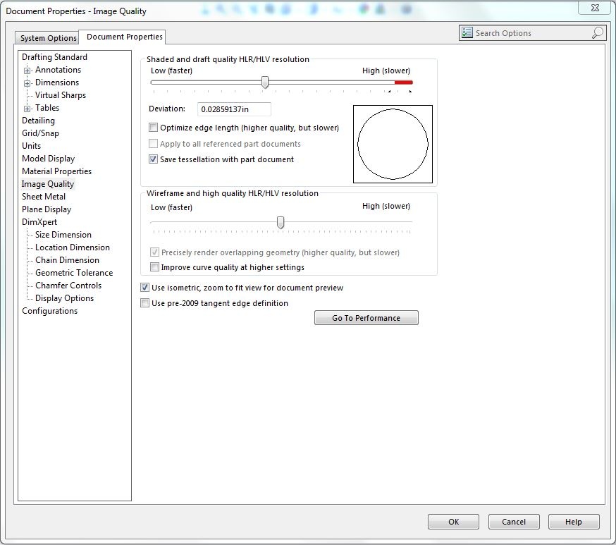

I believe the below setting is the culprit but I am unsure.
Here is the setting when STLS are saved out.
