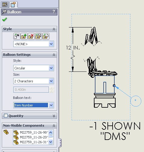

Item number callout shows *

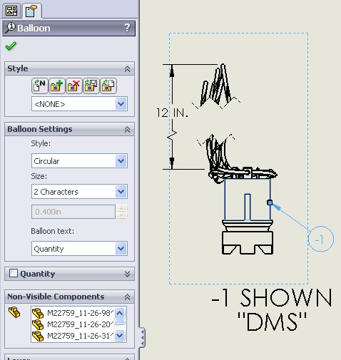

Anyone know how to fix this?
I have an assembly with a sub assembly. That sub assembly is shown in the BOM as Item 2. The Balloon points to the sub assembly. It has a quantity of -1, item number of *, and the custom properties all link properly.
If I right click on the drawing view, it is linked to the correct bill of materials. This happens in all drawing views. Other drawing views have components that correctly link to the BOM item numbers. I have a different configuration shown on this same drawing. It has a different configuration of the same sub assembly in it, and it links properly. I have also tried using auto-balloon, and that just creates another balloon to the part, with the same issues.
