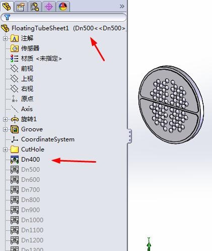

IsSuppressed2→true and false
2010 SolidWorks API Help - Is Feature Suppressed in Specified Configurations Example (VBA)
http://help.solidworks.com/2010/english/api/sldworksapi/IS_Feature_Suppressed_in_Specified_Configurations_Example_VB.htm

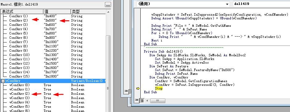

Private Sub del1419()
   Dim SwApp As SldWorks.SldWorks, SwModel As ModelDoc2
      Set SwApp = Application.SldWorks
      Set SwModel = SwApp.ActiveDoc
   Dim SwFeat As Feature
      Set SwFeat = SwModel.FeatureByName("Dn500")
      Debug.Print SwFeat.Name
   Dim ConfArr, vConfArr
      ConfArr = SwModel.GetConfigurationNames
      vConfArr = SwFeat.IsSuppressed2(3, ConfArr)
      Stop
End Sub

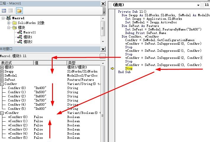

Private Sub ll()
  Dim Swapp As SldWorks.SldWorks, SwModel As ModelDoc2
    Set Swapp = Application.SldWorks
    Set SwModel = Swapp.ActiveDoc
    Set SwFeat = SwModel.FeatureByName("Dn400")
    vConfArr = SwFeat.IsSuppressed2(0, ConfArr)
    Stop
    vConfArr = SwFeat.IsSuppressed2(1, ConfArr)
    Stop
    vConfArr = SwFeat.IsSuppressed2(2, ConfArr)
    Stop
    Stop
End Sub
