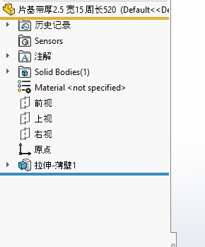

When I run my macro in a batch process it does not work but it does if I use it in the part file directly. I am using a SolidWorks add-in that my company develops but I was wondering if it was part of the code that is having issues when using in a batch process.
batch process
When I run the macro directly in the on the part by individually opening it:
