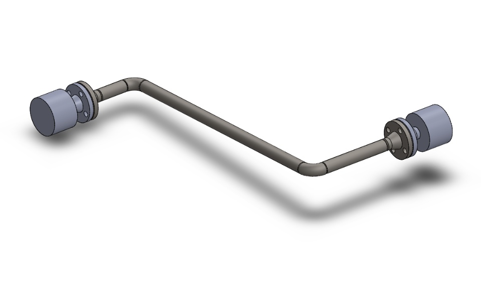

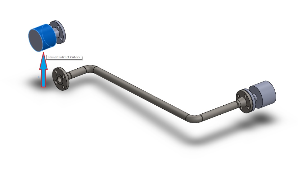

I have created a small part out of typical piping flange. And will insert two instances and connect them with pipe
Image 01 - showing part i created.

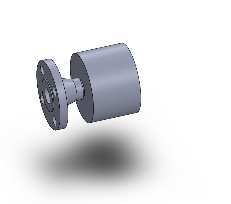

Image 02 - adding one more instance to connect. spacing them randomly apart.

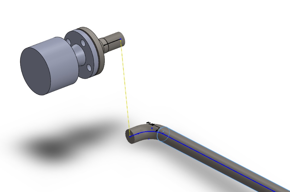

Image 03 - starting a route (all normal so far)

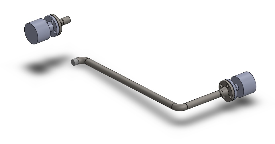

Image 04 - connecting two parts. all good at this point

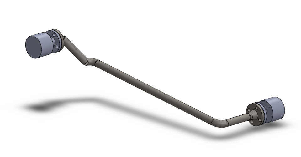

Image 05 - as parts were not fixed i grab one and move it.

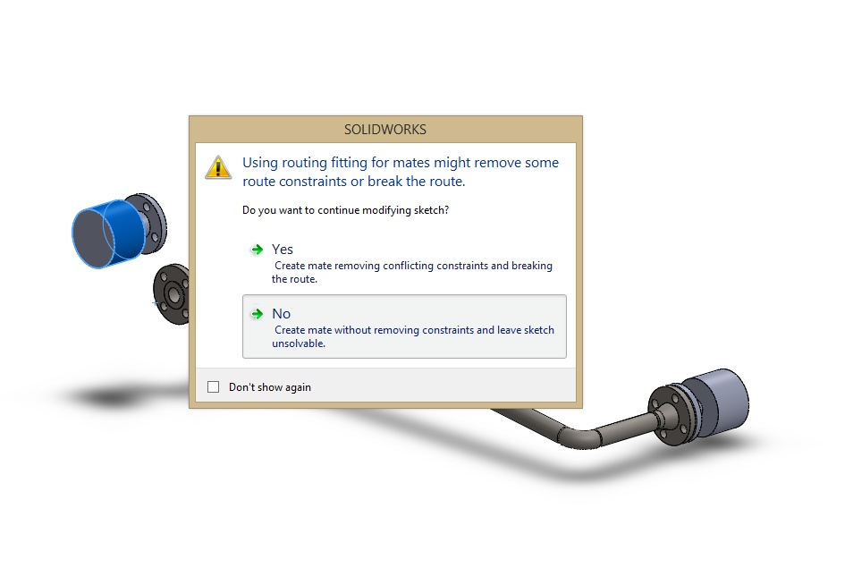

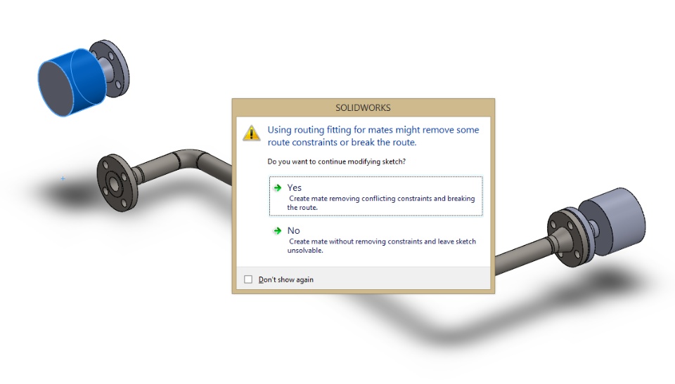

Image 06 - boom. at rebuild i get this message. This message usually appeared when you would add mates to routing parts within route assembly. i am in my main assembly at this point.
Image 07 - i hit YES and this is what i get.

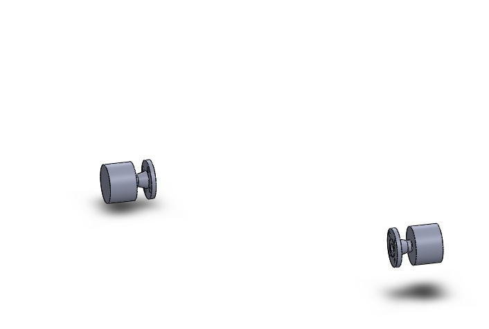

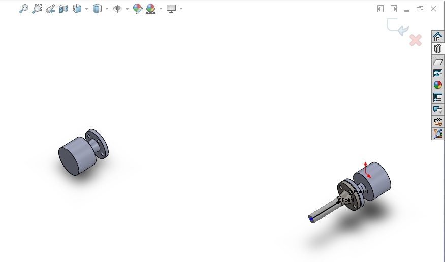

Image 08 - edit the route to see what is going on, and.... this is crazy. in 2015 changes like these were flawlessly taken care of. Imagine having multiple routes attached to this part. All of them will be broken at some point.
Image 09 - i go back couple of steps and say NO to the dialog
Image 10 - but result is the same.
