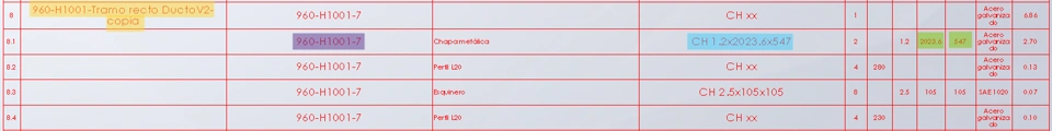

Image 1:
In this case, it can be observed that a component of a specific configuration of a part shows an incorrect LENGTH x WIDTH measurement. These dimensions are only corrected when the corresponding drawing is opened, at which point the cut list is updated and displays the correct values. In other words, ​the dimensions are only updated correctly after the drawing is opened, which is necessary to obtain accurate dataBOM
Image 2:
Here, the change in the dimensions can be seen, with the correct measurements now displayed after opening the corresponding drawing.

a shot in the dark.  I would say that your cut list options are off or you are not getting the proper rebuild to update the data.  Which can be anything from a system setting to something else.
I would like to see the tree for the assembly to see how the file is set up.
