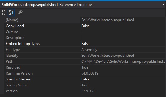

Hi, I've got an issue when I try to unregister an addin.
I use this cmd to unreg it :
"%windir%\\Microsoft.NET\\Framework64\\v4.0.30319\\RegAsm.exe" /u "C:\\MyAddin.dll"
pause‍‍
but this give me the following error (rough translation from french) :
RegAsm : error RA0000 : Cannot load file or assembly 'SolidWorks.Interop.swpublished, Version=27.5.0.72, Culture=neutral, PublicKeyToken=89a97bdc5284e6d8' or one of its dependencies. The located assembly's manifest definition does not match the assembly reference. (Exception de HRESULT : 0x80131040)
But when I check the addin in visual studio I've got the goo version for SolidWorks.Interop.swpublished
How can I fix this issue ?
PS : I've got the same issue when trying to register the addin
