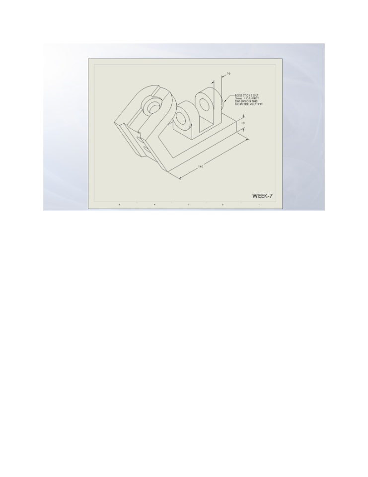

I want to create a couple of assignments for my students that reflect the old-style Isometric views you used to see in the old drafting books.
It does not matter if I choose True or Projected dimensions. Not all of the dimensions can be added because of the complexity of the part...but yet they used to do it in the 60's in the old drafting books.
I'm a CSWE...used the program for over 16 years...and am certified in Mechanical Drafting.
Is there an option I just can't find? Is this possible in SW-2013?
I would appreciate any help.
