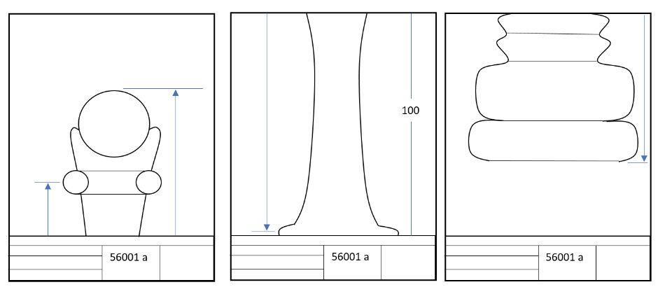

Is there a way to split a long part into a multi-sheet drawing?
Hey everyone, I'm trying to do something a bit unconventional here... We've got some long narrow part drawings which one of our plants would prefer to have split into multiple (3) sheets and I'm just trying to determine whether or not it's possible. They're currently using AutoCad for this , but we would like to switch over to SW.  I've attached a quick mock-up I did , using a chess piece for reference, to show what I'm describing in case it wasn't totally clear. Basically the sheets act as a window into the larger drawing view where dimensions can start in one sheet and continue on to the next, etc.
