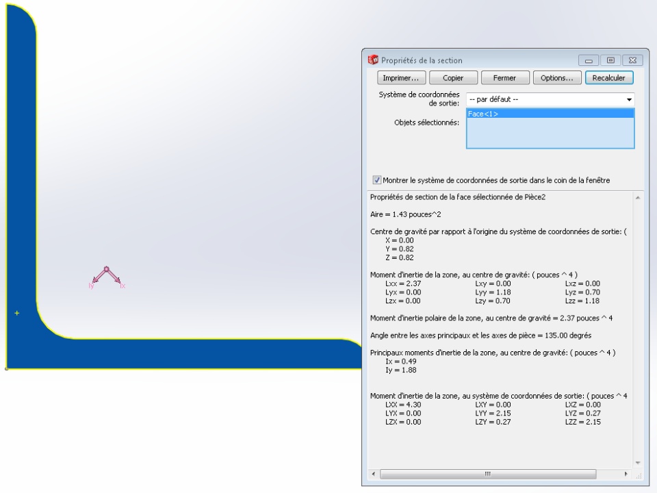

I am an engineer and I am very new to solidworks. I wonder if there is way to show 'area moment of inertia' (often known as I, in unit of in^4 or cm^4) of a custom beam? I am able to find moment of inertia from 'the mass properties' but it is not what i need.
Besides, I also would like to know where to show section modulus / cross sectional area and other engineering data commonly used for beam designing.
