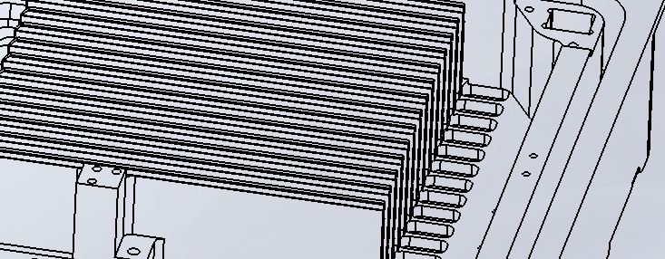

Now, in the model I can easily make section views to get at hard to see/hidden features within a part. But is there any way to show that in a drawing? I basically want to make a view like this;

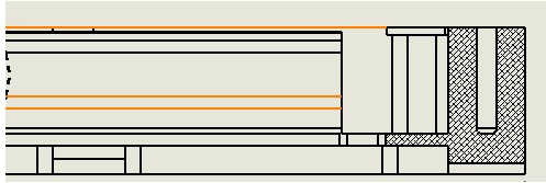

which is a small slice of a part. But when I try to do something like that in a drawing view, I can only make the standard section views;

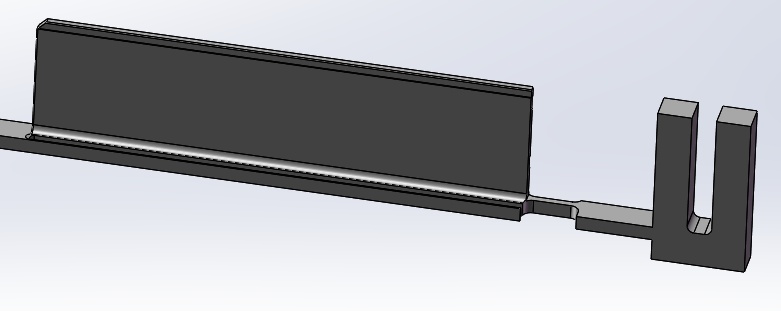

or 3d views without sections;
Is there some special trick to turning a 'section view' into a 3D view that I don't know about? Or is the nearest thing I can do is to make a new part that is just a small section of the original part and use that for the special section views?
