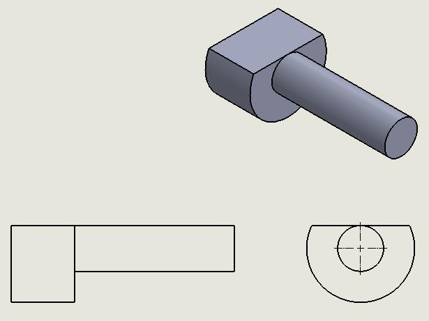

Hi, is there a way to geometrically tolerance (or otherwise tolerance) that a face should be tangent to a cylindrical?
I have a pin, with a large diameter at the base, and a small diameter coming out from that. I need to grind a flat on the base, that needs to be tangent to the smaller diameter.
