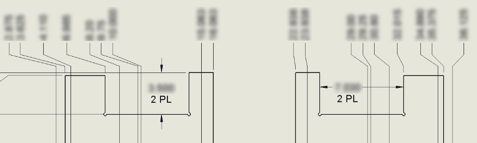

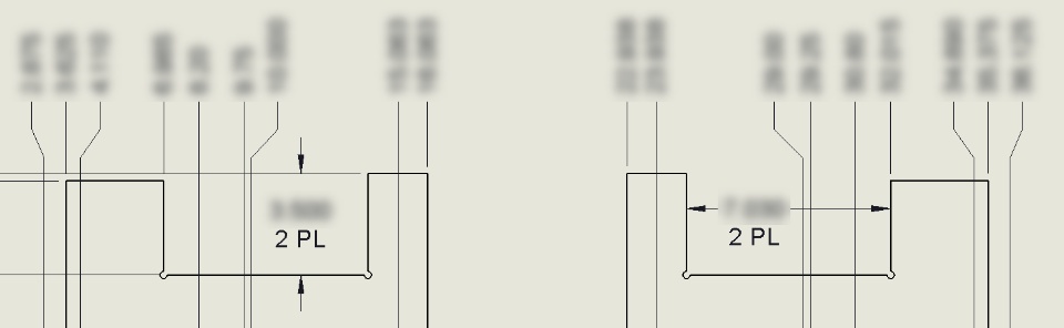

Does anyone know a quick way to space out ordinate dimensions that still looks aesthetically pleasing? I know there's an option to "re-jog ordinate", but when I use this command I typically don't like the result and have to manually jog the dimensions anyway. For instance, I manually placed my dimensions at the top of my part as shown in the first screenshot below. Then I was making some changes to dimensions at the bottom of my part and used "re-jog ordinate", which caused the dimensions at the top to move to the positions shown in the second screenshot (for the record, I didn't like the result at the bottom either):
I feel like the re-jog command would work well for me if it would ONLY move the dimensions that already have a jog in them, and leave all straight-line dimensions alone. I don't use ordinate dimensions too frequently, but every time that I do I seem to run into this problem.
