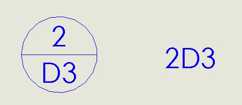

Our drawing standards for location labels are shown in the image below, on the right-hand side. Solidworks' automatic location labels are of the form on the left-hand side. I have played around with the document settings and could not devise a method to have location labels look like our drawing standards automatically.

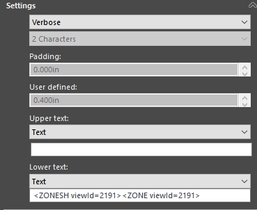

I have resorted to manually editing the location label properties, shown below, to get the desired result.
