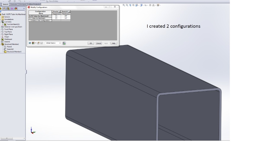

I created 2 configuration features in the same part file (Modeling). Those names are 1. 3/8" tube and 2. 1/2" tube.

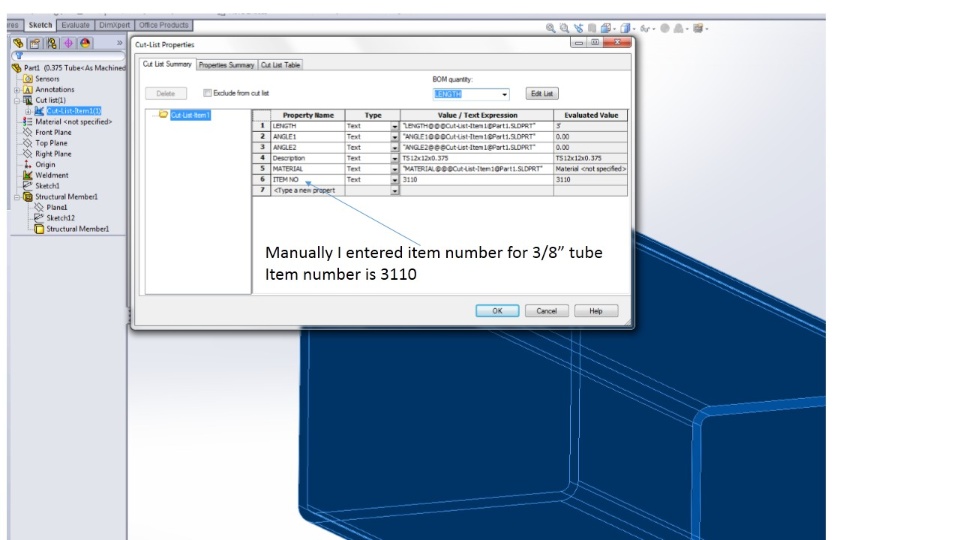

For 3/8" tube:
Tube size: 12" x 12" x 3/8" THK x 3'-0" LG.
I entered manually for Item number is : 3110 (This number given in the cutlist)
Then I switch to 2nd configuration feature i.e 1/2" tube
Tube size 12" x 12" x 1/2" THK X 3'-0" LG.
I edit same sketch based on configuration feature for 2nd configuration. successfully configuration 2 created, and i switched both configuration successfully worked.

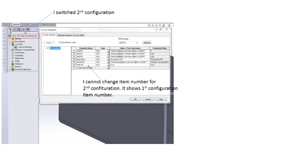

Then I try to change item number (3111)for the 2nd configuration in the weldment cutlist, But it has 3/8" Tube configuration item number. It cannot change.
3/8" thk and 1/2" thk are not equal. I need reflect different item numbers for both configuration. It's help us what i create for large assembly.
Any one please give us a solution for this problem.
