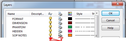

I have a notes layer set to visible and non-printing.

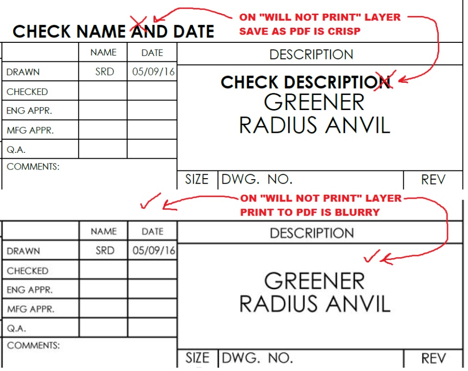

I have printed to a printer and the notes do not print. (:
I have printed to PDF and the notes do not print. (:
When I Save As PDF the notes are printing which is frustrating! ): I cannot use print to PDF because the quality is blurry.

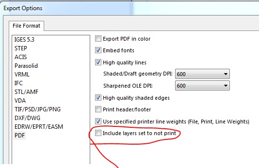

I checked the PDF setting and "Include layers set to not print" is off.
