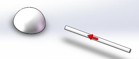

As I just set these two simpler components to describe my question.
↓This is the starting point of the motion.
↓As you can see, after the crash, the motor direction is still not changed.

The "Notes" on the bottom says "If something causes the reference point of the motor direction to change, the motor continues to move the component in the new direction. This can occur, for example, if there is a collision between the component that is moved by the motor and another component."
The motor position is referenced in the cylinder and the direction is referenced to one end surface of the cylinder.
Can someone help me with it? I really need it to help with my project.
