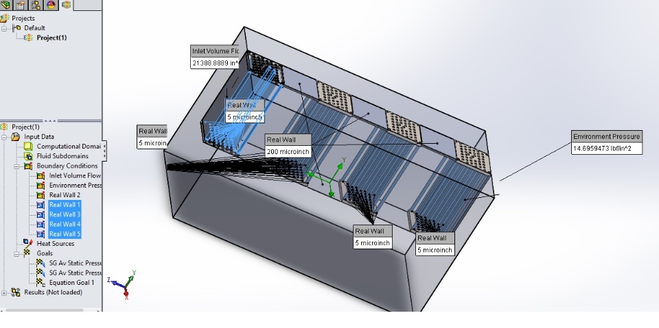

I'm trying to find the head loss/pressure drop across an open channel for a specified flow rate. The picture below shows how the system looks.
Basically water flows through the left face, and has to go around a bunch of these glass rods, and exits out the other face.
Setup
  • Left face is an inlet with specified volumetric flow rate
  • Right face is specified to be environmental pressure
  • Surface goals are set up to be the average static pressure at inlet, and average static pressure at outlet
  • The rods are glass, so I set up a wall condition on them to have a roughness of 5 microinches (found this number online)
  • The base and "roof" of the system are steel, so they have a roughness of 200 microinches
Problem
I then run an internal analysis, and find that the pressure difference/head loss between the inlet and outlet is about .82 psi, which is way too high (it should be around .20 psi). This number doesn't change much if I change the roughness of the glass rods. However, if I specify 0 roughness for the glass rods, the head loss is around .20 psi, which is strange.
So, my questions are: Am I doing something wrong in my setup here? How can I diagnose this issue of having too high of a number? Is it possible that the glass rods aren't even recognized, and water's flowing straight through them?
Thanks,
Scott

How does your mesh look around the tubes? It seems to me like you're starting out with too much detail. I would try to simulate just one of these bundles, maybe even just a 2D analysis and increase in complexity from there.

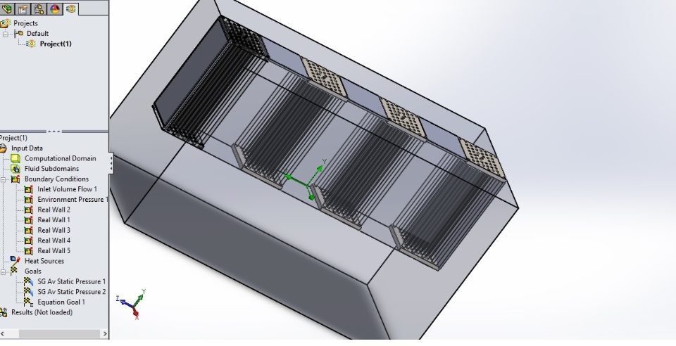

I created a local mesh to refine it around the cylinders a lot more, as well as testing using half-symmetry, and then quarter-symmetry (and reduced the inlet flow accordingly). I used a 3d comp. domain because the 2d was giving me some computing/memory issues for whatever reason. From these two tests, I get numbers that are way off from 6" of head loss again. However, there's an issue when I display the trajectories that could be related to this problem: the trajectories don't go all the way through the system, only up to a certain point.  See below pics for the setup:
The local mesh around cylinders:
Half symmetry:
Trajectories that stop short:
Any idea of what's going on, or what my options are from here?
Thanks,
Scott

If you're looking to compare effects of roughness you need a LOT finer mesh.  If you look at the mesh without the parts I couldn't even tell that those are round pins and not square/rectangular.  Until your model looks just like reality the roughness is irrelevant.  On flat surfaces it would be useful, but when your circle looks like a square the rectangular approximation makes your roughness equal to your mesh roughness.
In the Flow Trajectory tab what is the length limit of the paths shown?  How big is this model actually? (.001" rods, 1" rods, ?)
When you setup symmetry did you use fully 1/2 or 1/4 of the model?  The highlighted yellow region does not appear to be 1/2 of the thickness.

I'm not trying to compare the results of the different roughnesses, just a constant roughness of 5 microinches on the cylinders. How can I make the mesh recognize the curvature even more, because the mesh levels are already pretty high, and Solidworks can barely calculate the mesh/run the simulation as it is. The local mesh settings around the cylinders are currently:
     Solid/Fluid Interface
  • Small Solids Features Refinement Level: 5
  • Curvature Refinement Level: 5
  • Curvature refinement criteriod: 0.389 rad
  • Tolerance Refinement Level: 5
  • Tolerance refinement criterion: 5.85in
     Refining Cells
     Just "Refine fluid cells" and "refine partial cells" are checked and are Level 5

I would likely alter your basic mesh settings so that the mesh around the rods has the same size in both directions (look like squares instead of long thin rectangles).  You are creating a lot of cells in the bulk flow region that you may not need if the flow around the rods is your primary interest.
Unfortunately, it might also benefit to put reference planes in the center of your rods so that you know they are all resolved the same.  It would be a royal pain to add them, but the more effort you put into setting up the initial mesh the easier it is for the software to get the answer you are looking for.  Many of my models can take several full days to create all the BCs, ICs and local meshes but when it takes a day for each configuration and you're comparing a dozen changes it gets easier to justify the time up front.

Scott, your mesh looks very rough. Can you post a screenshot of a mesh only cut plane, and please be sure to  toggle off "use cad geometry" in the cut plane definition. I think you may be surprised at what your solids actually look like.
