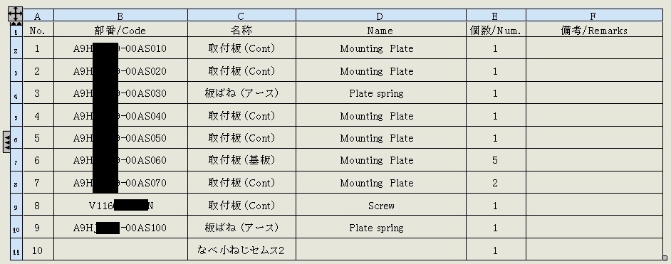

Can you see the ex1.jpg image?
This is the table image what Assembly file's draw file.

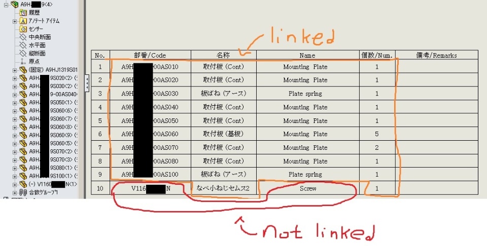

Cells amost linked part's propertys, Except wraped red.
table's no 10 record was be linked V116~ File's
And the not linked two cell moved to no8 record.
But, No8 record still linked A9HXXXX-00AS080.SLDPRT file, just showed like that.
If i Edit No8's B and D field to blank. they are changed A9HXXXX-00AS080 and Mounting Plate.
I don't know why happen like this.
please teach me if you know reason of this phenomenon.
