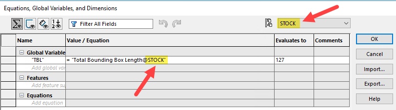

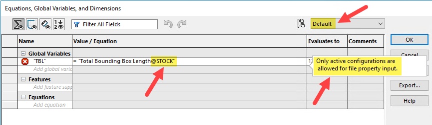

Is it possible to use config specific value in a global variable?
I have a part file that contains two configs, Default and STOCK. The STOCK config has a bounding box that represents the necessary material size to order. I want to reference the relevant config specific values in global variables so that I can insert them into the drawing title corner.
My problem is that SWX states that this isn't allowed. Does anyone know a work around?
