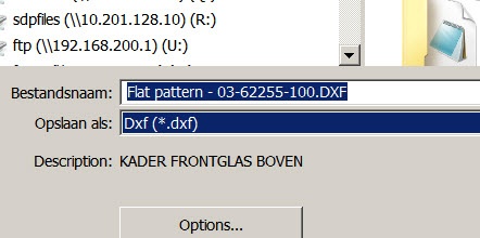

In our organisation we would like to add the Dutch equivalent of "flat pattern" at the end of the filename when usung the export to DXF function.
example "Flat pattern - 03-62255-100.DXF" should be "03-62255-100_ontvouwing.DXF"
We would like to set this for all exported DXF files.So it would be great to have this as a setting somewhere.
Same result can be achieved with a macro, but then we loose the flexibility of the export wizard. (we like to have control over the entities we want to export for every individual file)
