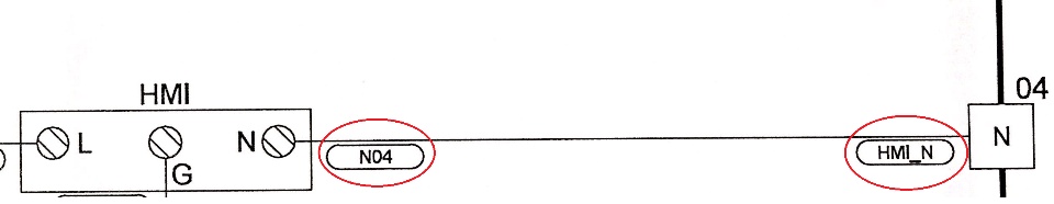

My company currently labels wires manually using a method shown in the image. The wire label shows what it will connect to on the other end. So at the HMI, the label says "Neutral Terminal Block 04" and at the terminal block the label says " HMI Neutral". Is there a way to do this automatically in SWE 2016?
I can get the wire marks to show origin and destination but I can't figure out how to make the wire label be different at each end.
