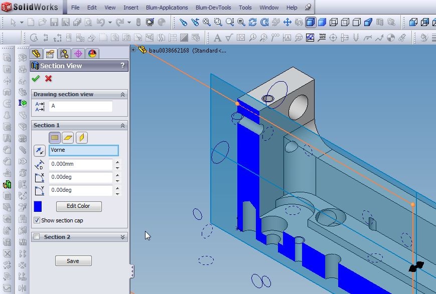

Is it possible to have a "preview" on customized "section view method"
Hi to everybody,
the screenshot shows the cut view property manager and the preview upon calling the section view in solidworks.
I would like to implement a customized section view method which would allow to select a cylinder (then take the center of the cylinder and create an appropriate reference plane there  ... the details of this are actually of no concern here - my question is a more general one).
I recored with the macro recorder what was going on beneath the standard "section view" in solidworks - obviously the macro recorder can only eavesdrop on API calls after the OK-button  (the green tick) has been clicked:

If one calls the section view does some adjustments in the property manager and then cancels the property manager - then the macro recorder does not record much:
Dim swApp As Object
Dim Part As Object
Dim boolstatus As Boolean
Dim longstatus As Long, longwarnings As Long
Sub main()
Set swApp = _
Application.SldWorks
Set Part = swApp.ActiveDoc
Dim myModelView As Object
Set myModelView = Part.ActiveView
myModelView.FrameState = swWindowState_e.swWindowMaximized
boolstatus = Part.Extension.SelectByID2("Vorne", "PLANE", 0, 0, 0, True, 1, Nothing, 0)
Part.ClearSelection2 True
End Sub
My question: Is it all somehow possible to have previews on customized methods in solidworks ?
