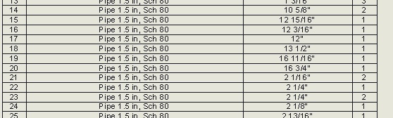

Is it possible to get the BOM to sort the lengths correctly?
When I make a drawing of a pipe routing I sort the BOM by description and length. For some unknown reason SW thinks 16.75 is smaller than 2.0625. I guess becasue it starts with a 1. Is there a way to get it to sort be increasing length not "alphabetically by number"?
SolidworksRouting
