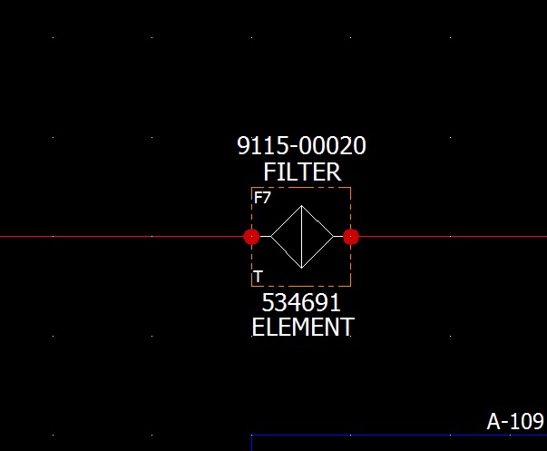

Is it possible to display the description and part number of TWO manufacturer parts on one symbol?
I have this situation come up at least a few times per drawing, and was wondering if someone could help me out...
I have the filter shown above, and below I have manually inserted text for the filter element for reference when a customer is ordering parts.  In addition, I have inserted the filter element manufacturer part into the symbol to add it to the BOM as required.
Is there a way to get the element manufacturer part info tied to the symbol itself along with the filter head to avoid the redundant data-entry and prevent possible errors?
