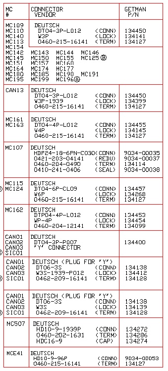

Is it possible to combine identical BOM's? Am i asking too much?

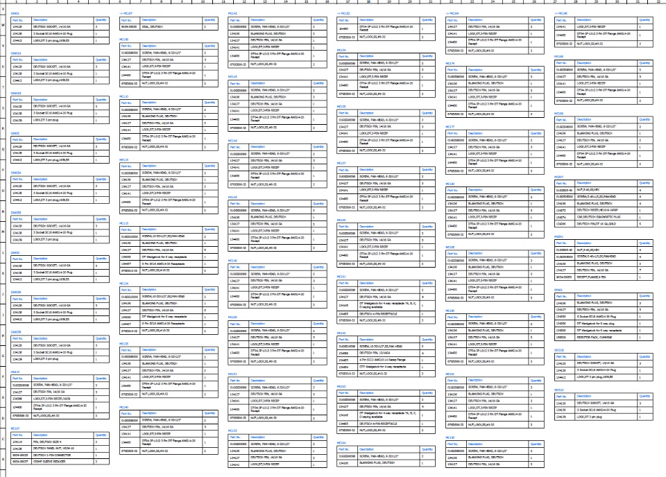

I have the following report, detailing the components in each connector in a particular cabinet:
If you look closely, you may notice that around 30 of these BOM's are identical.  I'm curious if there is a way to combine them, something like our original reports...
This report was originally created manually, which was a tedious and error-prone process, but the result didn't fill a D-size sheet:
Obviously the above report is not easy to keep updated and accurate compared to a SWE project report, but it doesn't require its own sheet, which is a plus.
Am I asking too much for SWE to get me at least a little closer to this?
