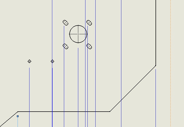

In the What Minor Bugs Drive You Crazy? It was suggested that we split them up some so the SW people can pay attention to those that they deal with so i will start this new one. This evening as I was dimensioning a part with slanted slots using Ordinate dimensioning I found that when the Hole Wizard slots have center marks in them SW will select the center mark ( or the center of the side not sure which) rather than the center of the slot. See below. Now I can and will place a point in the center as a work around but it would be nice not to have to do that.
Interesting, I went back and placed the points and then could not get the slots to take a dimension until I had deleted the center mark. I then dimensioned to the point and replaced the center marks.
