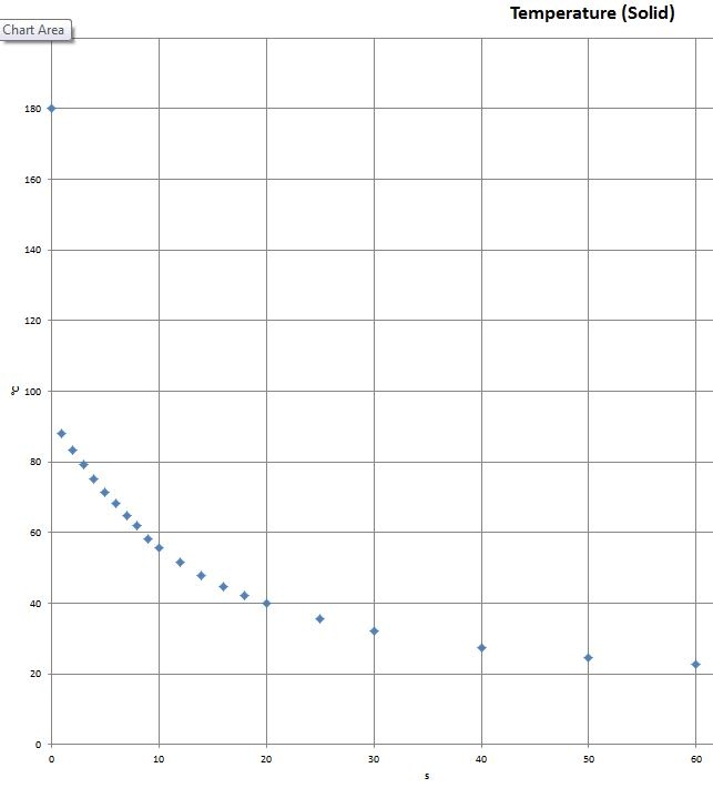

I'm running a 2-part flow model, first for the flow, then feeding those results into the thermal model.
While watching the solver do its thing, I see what I expect as far as a thermal gradient.  Once the solver is done and I load the results, I create a Point Parameter to get the results into Excel.  What I see there is odd.  The temperature falls almost instantly to around half at the first time step, then decreases asymptotically after that.
This behavior is the same at a different initial temperature.
Am I setting up something incorrectly, or misunderstanding something?

can you elaborate on what your analysis setup is or what you're comparing your point parameter against?
what happens when you look at the cutplots and use probe? are they correct?

Jared,
  I made a rookie mistake, had water selected as the default fluid rather than air.  That would account for the incredible heat transfer rate.  Oops.
