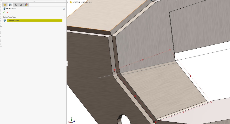

I'm building multibody sheet metal weldments in a single *.sldprt file. (if a part is all welded I've traditionally drawn it as a single *.sldprt)
Probably the most annoying thing that has plagued me over the past years has been the instability in my method of cutting intersecting sheet metal bodies.
*see attached image
As shown, what I have taken to doing is making a sketch on one of the intersecting faces... super simple... click the sheet metal face.. so on.
once in the sketch I used to do use pierce point mate the line to the edge of the adjacent face. but it was unstable. So I searched for another method.
I found the sketch command "intersection curve". I have **better** luck with it than pierce point.
I usually leave this line as it's own stand alone sketch (so it's easy to fix, I know instantly what happened when that sketch and the two following cuts fail), then start a new sketch on each of the bodies to cut off the excess using "convert entities" on that line.
but... still not stable. I opened this model this morning after it being stable all last week and boom.... error'ed out.  so frustrating.

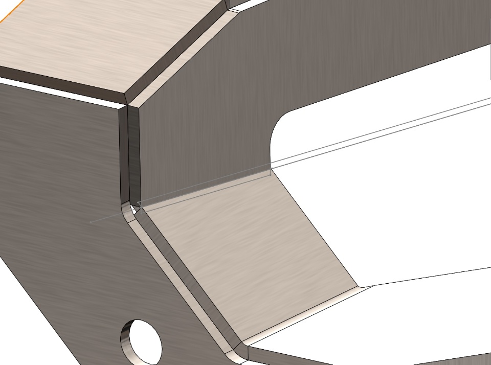

What it should look like:
I don't think it has anything to do with the sketch itself. Usually I loose one of the sheet metal face sketch planes... it has to be something like solidworks renaming the sheetmetal bodies internally and loosing its references.
