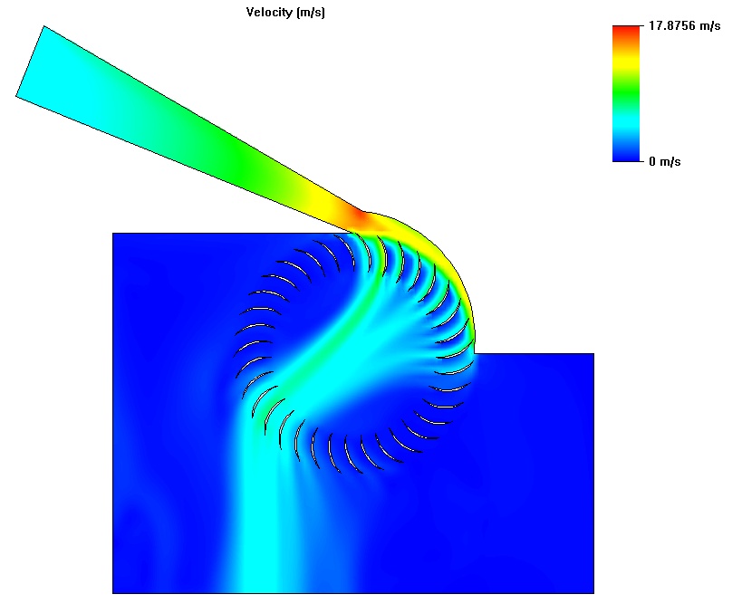

I have desigened the stator and the impeller, the impeller has been fully enclosed in an non-merged cylinder. Since this is an impeller it is designed to "Rotate" and here is my problem, i can run the simulation no problem when the rotating region option in the wizard is turned off, i have a screenshot below of the result:

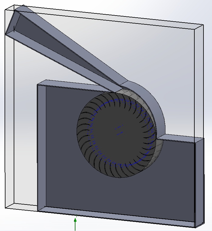

Here is a screenshot of the design:

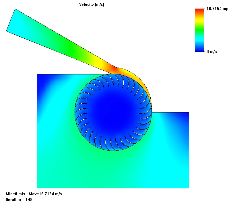

For the rotating analysis the rotation is set to 20 rad/sec in the correct direction and the enclosing cylinder around the impeller is switched "off" in "component control".
when i run the simulation this time here is my result:
As you can see the water is not flowing throught he impeller!!!!! I can't understand it.
I have gravity also switched on and my reference axix is "x", im not sure if this have any error induced or not but any help is welcome.
