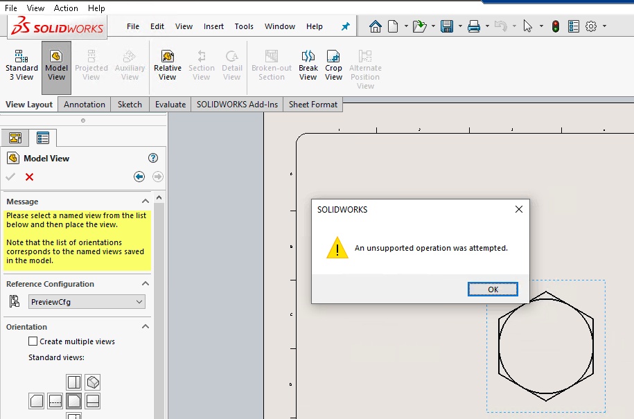

My institution is having issues with Solidworks 2019 intermittently crashing when inserting a part into a drawing, with "An unsupported operation was attempted". Once it happens, every subsequent attempt fails.

The only other idea is to try and push Solidworks 2020 to the classroom.
The dump message
