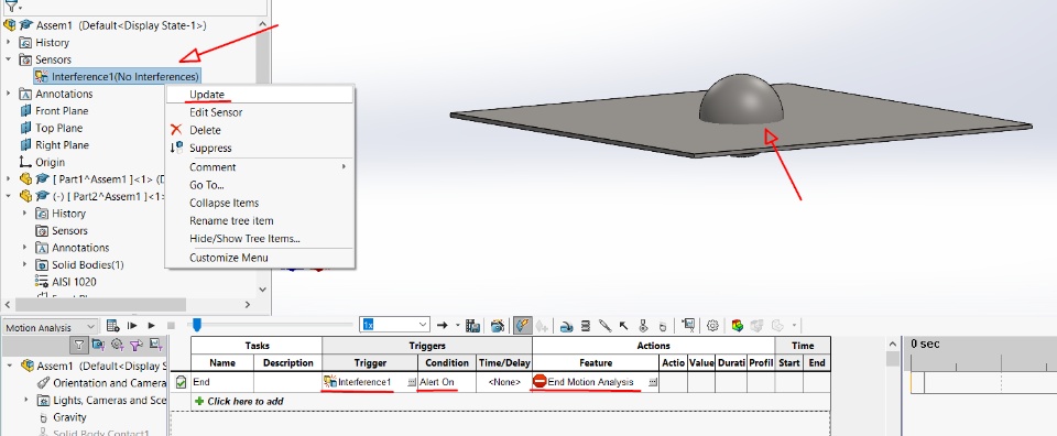

I have an event based motion analysis, and want to stop the study when there's some interference. The interference I need to detect is a component falling with gravity, and touching the ground.

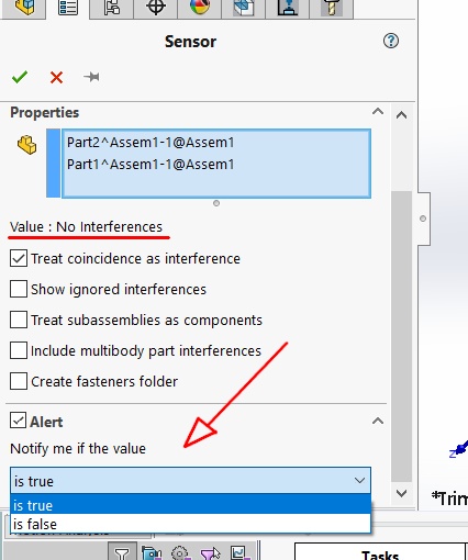

For that, I use a sensor with an alert set to "Notify me if the value is true":
The problem is the sensor does not update when I calculate the motion analysis. The only moment the sensor updates and notify me that there's an interference is when I edit the sensor and close the edit menu:
So, when I run my motion analysis, the ball go through the ground and it doesn't trigger the "End" task which is supposed to detect interference between the ball and the ground.
Using SW 2020 on Windows 10.
