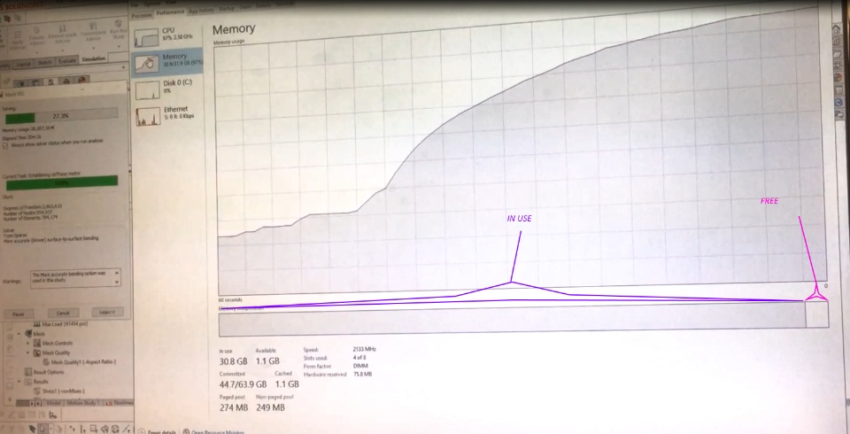

Now it appears to me, from watching the KPIs available in resource monitor and the windows 10 task manager, that the Intel solver is unable to free the memory it's using quick enough to keep up with itself. Here's what I mean:

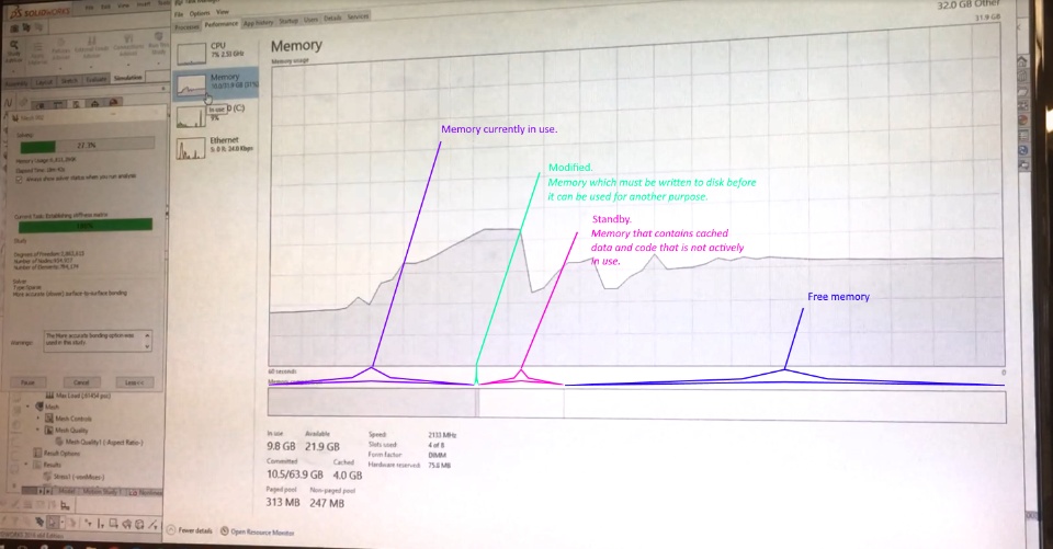

Pre-balloon memory composition:
Lots of available free memory, a little in standby, very little "modified" memory.
Early balloon memory composition:
Lots of memory being used, very little free.
Seems to be ramping up and taking good advantage of the available memory.

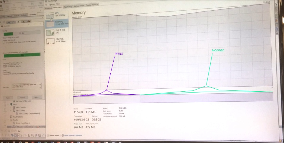

Mid balloon memory composition:
No free or standby memory; "modified" memory is starting to overtake the memory in use.

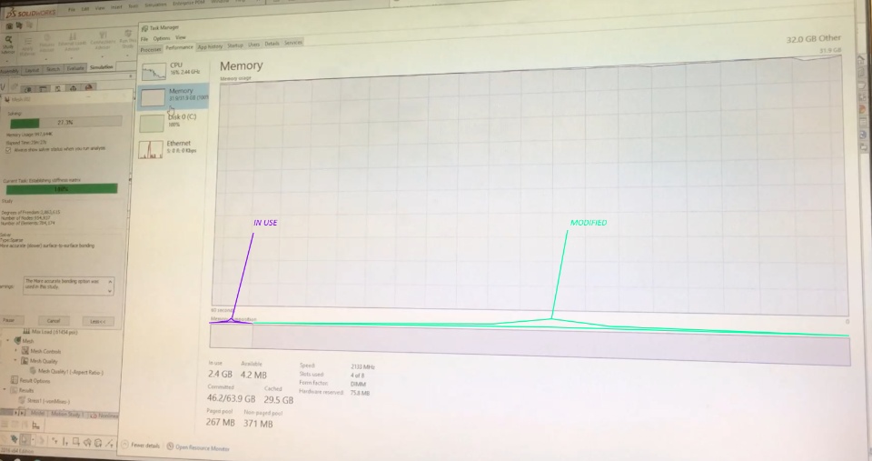

Late balloon memory composition:
Almost everything is "modified" memory; it seems to me like the solver is unable to release this memory and it's growth just spirals out of control.

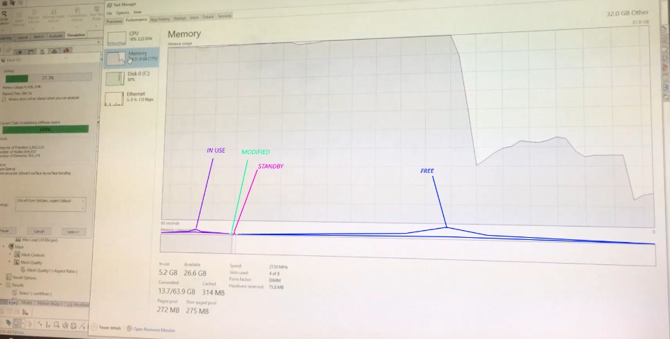

Post balloon (balloon burst) memory composition:
The solver appears to have quit, and the memory has been freed back up again.

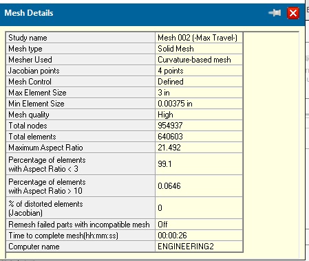

And here are the mesh details from that study:
