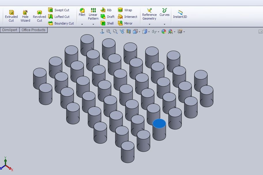

Hi,
I am trying to insert a dome on a face by selecting it using the Select4() method. However, this does not create the dome when the InsertDome call is made.
PartDoc part = (PartDoc)swModel;
            object[] arrBody = (object[])part.GetBodies2((int)swBodyType_e.swSolidBody, false);
            if (arrBody.Length > 0)
                int i = 0;
                int currTopFace = 1;
                foreach (Body2 body in arrBody)
                    object[] faces = (object[])body.GetFaces();
                    foreach (Face2 f in faces)
//only faces 1,4,7,10,13..... must be used for the domes
                        part.SetEntityName(f, "face" + (i++));
                        if ((i - 1) == currTopFace)
                            ((Entity)f).Select4(true, swSelData);
                            swModel.InsertDome(0.00365, false, false);
                            swModel.EditRebuild3();
                            swModel.ClearSelection2(true);
                            currTopFace += 3;
Please advice.
