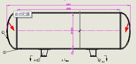

InsertCenterLine2,How to select Edge?
Follow code , can be select edge of shell. don't select ellipse edeg.
result is  ellipse, not center line.
